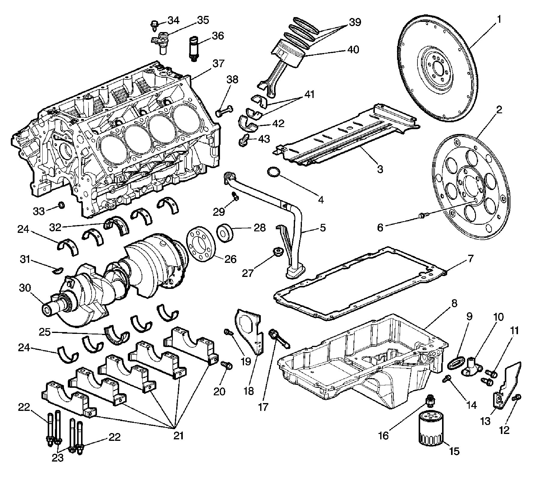

| (1) |
Flywheel - Manual Transmission |
| (2) |
Flywheel - Automatic Transmission |
| (3) |
Crankshaft Oil Deflector |
| (4) |
Oil Pump Screen O-ring Seal |
| (5) |
Oil Pump Screen |
| (6) |
Flywheel Bolt |
| (7) |
Oil Pan Gasket |
| (8) |
Oil Pan |
| (9) |
Oil Pan Cover Gasket |
| (10) |
Oil Pan Cover |
| (11) |
Oil Pan Cover Bolt |
| (12) |
Oil Pan Closeout Cover Bolt - Left Side |
| (13) |
Oil Pan Closeout Cover - Left Side |
| (14) |
Oil Pan Drain Plug |
| (15) |
Oil Filter |
| (16) |
Oil Filter Adapter |
| (17) |
Oil Level Sensor |
| (18) |
Oil Pan Closeout Cover - Right Side |
| (19) |
Oil Pan Closeout Cover Bolt - Right Side |
| (20) |
Crankshaft Bearing Cap Side Bolt |
| (21) |
Crankshaft Bearing Caps |
| (22) |
Crankshaft Bearing Cap Bolt/Stud |
| (22) |
| (23) |
Crankshaft Bearing Cap Bolt |
| (24) |
Crankshaft Bearing |
| (24) |
| (25) |
Crankshaft Thrust Bearing - Lower |
| (26) |
Spacer |
| (27) |
Oil Pump Screen Nut |
| (28) |
Clutch Pilot Bearing |
| (29) |
Oil Pump Screen Bolt |
| (30) |
Crankshaft |
| (31) |
Crankshaft Sprocket Key |
| (32) |
Crankshaft Thrust Bearing - Upper |
| (33) |
Engine Block Front Oil Gallery Plug |
| (34) |
Camshaft Position Sensor Bolt |
| (35) |
Camshaft Position Sensor |
| (36) |
Oil Pressure Sensor |
| (37) |
Engine Block |
| (38) |
Engine Block Rear Oil Gallery Plug |
| (39) |
Piston Rings |
| (40) |
Piston and Connecting Rod Assembly |
| (41) |
Connecting Rod Bearings |
| (42) |
Connecting Rod Cap |
| (43) |
Connecting Rod Bolt |
