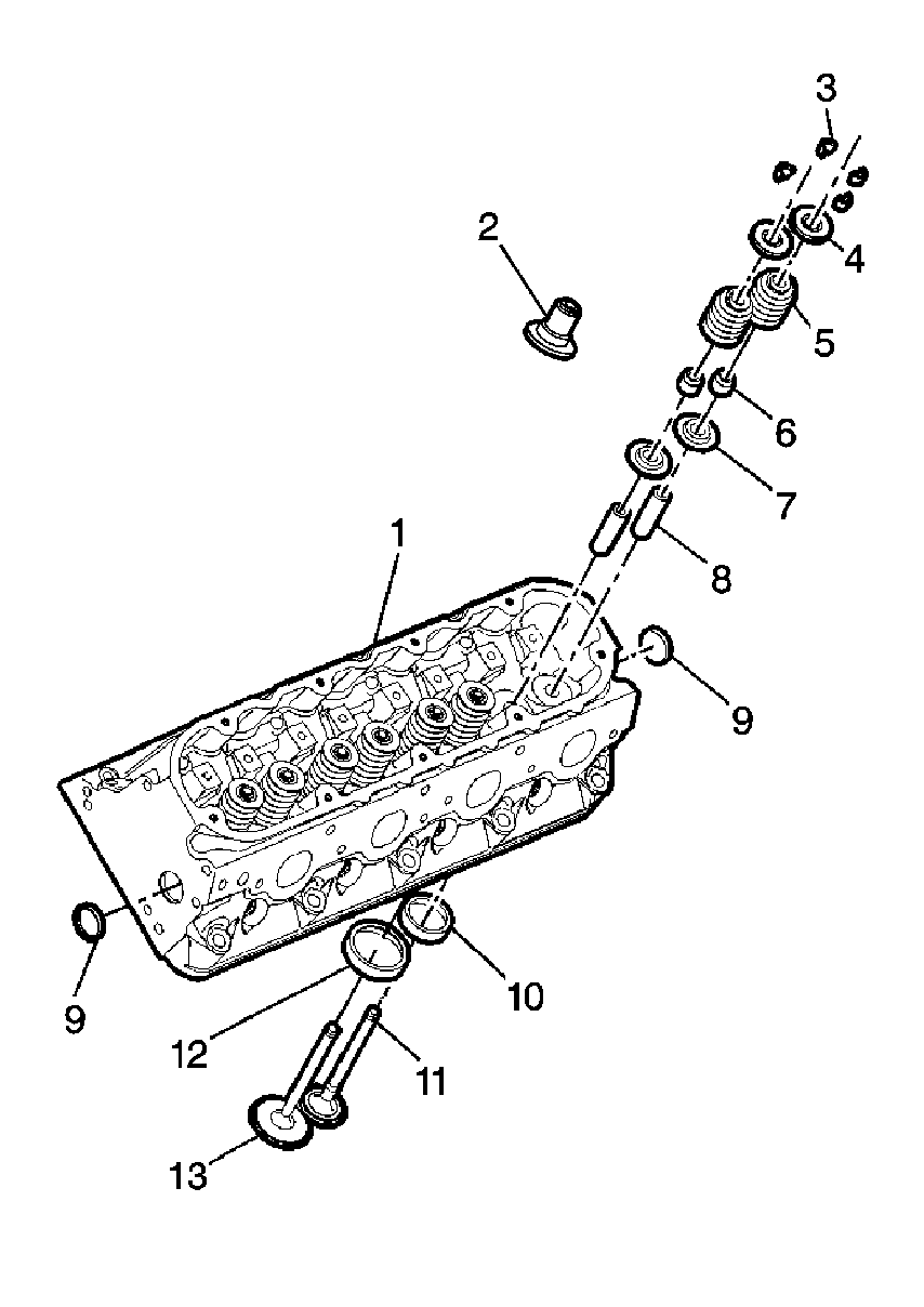

FIGURE Cylinder Head Assembly - Aluminum(c)
Object Number: 721939  Size: MH
Click here for detailed picture of above image.
(1) Cylinder Head
(2) Valve Stem Oil Seal and Shim Assembly - Second Design
(3) Valve Stem Keys
(4) Valve Spring Cap
(5) Valve Spring
(6) Valve Stem Oil Seal - First Design
(7) Valve Spring Shim - First Design
(8) Valve Guide
(9) Cylinder Head Expansion Plugs
(10) Exhaust Valve Seat
(11) Exhaust Valve
(12) Intake Valve Seat
(13) Intake Valve
