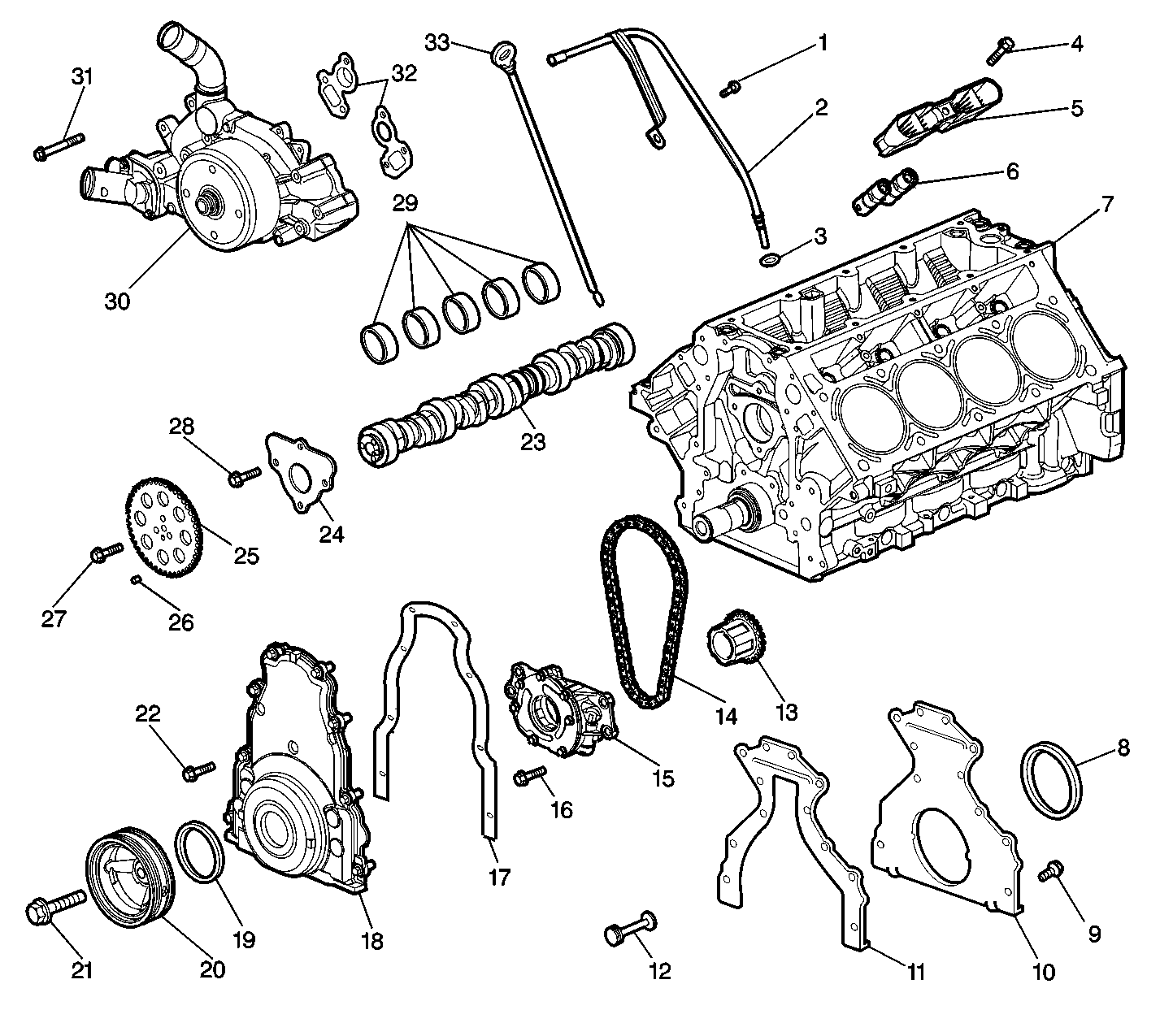

FIGURE Lower Front of Engine(c)
Object Number: 260163  Size: LF
Click here for detailed picture of above image.
(1) Oil Level Indicator Tube Bolt
(2) Oil Level Indicator Tube
(3) Oil Level Indicator Tube O-Ring Seal
(4) Valve Lifter Guide Bolt
(5) Valve Lifter Guide
(6) Valve Lifter
(7) Engine Block
(8) Crankshaft Rear Oil Seal
(9) Engine Rear Cover Bolt
(10) Engine Rear Cover
(11) Engine Rear Cover Gasket
(12) Engine Block Rear Oil Gallery Plug
(13) Crankshaft Sprocket
(14) Camshaft Timing Chain
(15) Oil Pump Assembly
(16) Oil Pump Bolt
(17) Engine Front Cover Gasket
(18) Engine Front Cover
(19) Crankshaft Front Oil Seal
(20) Crankshaft Balancer
(21) Crankshaft Balancer Bolt
(22) Engine Front Cover Bolt
(23) Camshaft
(24) Camshaft Retainer
(25) Camshaft Sprocket
(26) Camshaft Sprocket Locating Pin
(27) Camshaft Sprocket Bolt
(28) Camshaft Retainer Bolt
(29) Camshaft Bearings
(30) Water Pump
(31) Water Pump Bolt
(32) Water Pump Gaskets
(33) Oil Level Indicator
